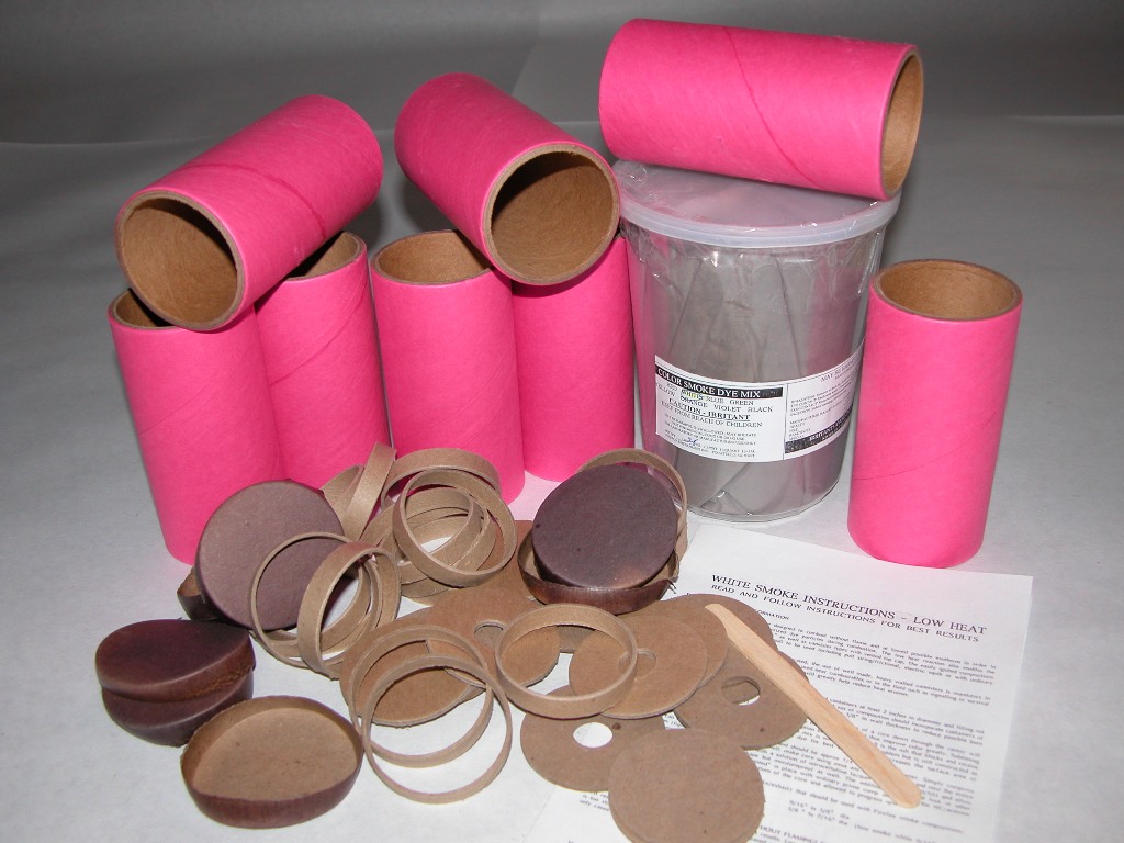

You can see some baffles here:
http://www.firefox-f...es/dscn2163.jpg
Most commercial smokes I've seen (and the ones in the above kit) only use a single disc which seems to work well.
