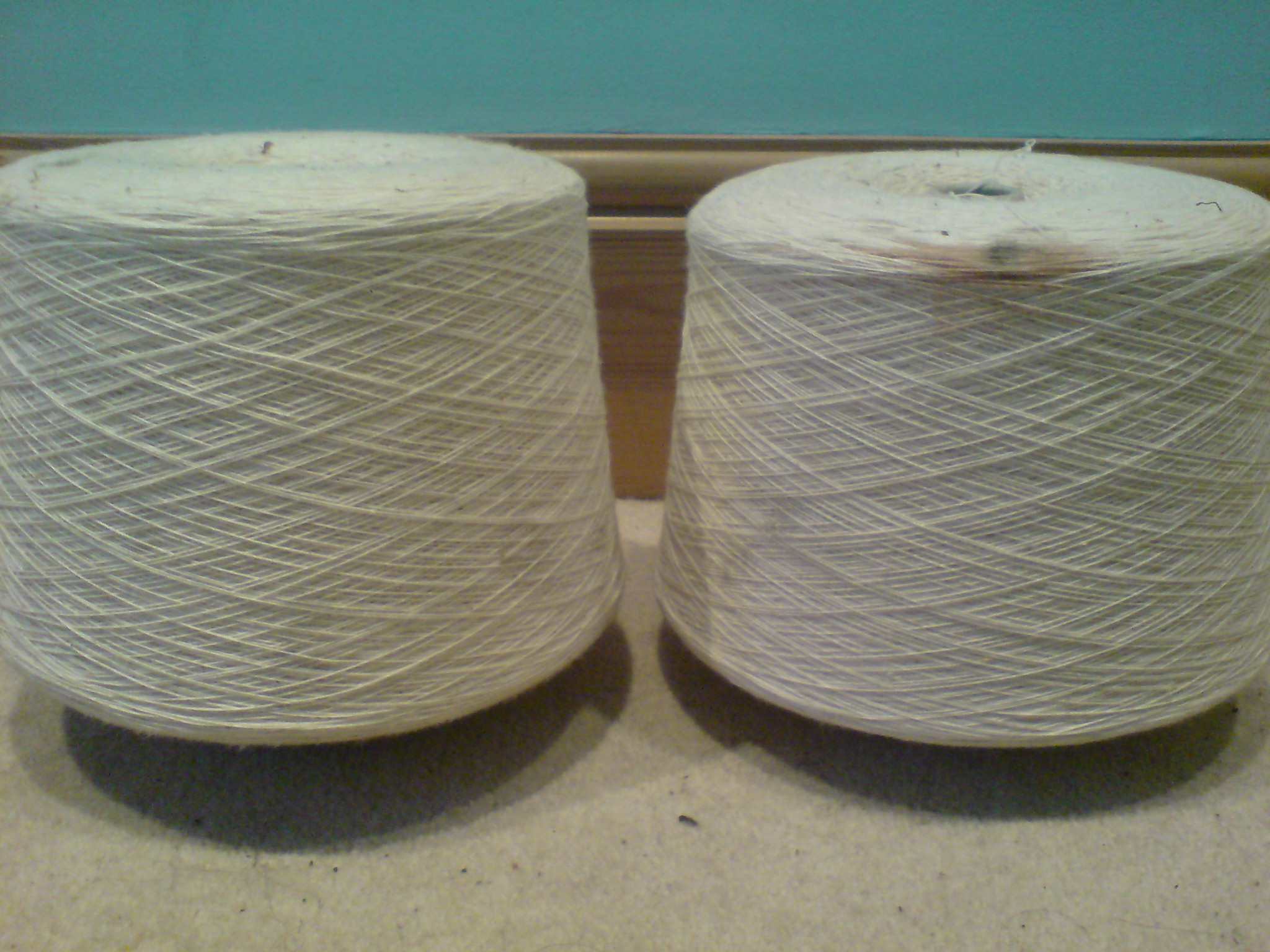

Posted 14 December 2008 - 02:20 AM
Try contacting weaving suppliers as I went to a local one and got 2 full rolls of cotton fine string to try with. There probably a few KM each and I've still got them almost full actually!
Edited by cooperman435, 14 December 2008 - 11:00 AM.
