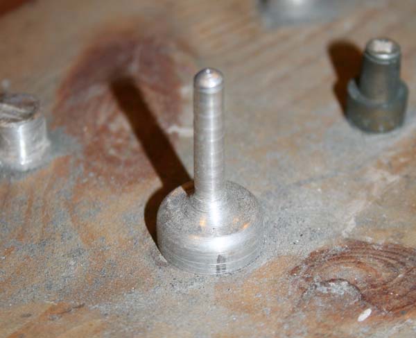

This is the spindle I made.
The base is 18mm, spindle height 30mm tapering from 4.5mm to 4mm after the flared part.

I'll be able to turn some tooling now, , phil I'm afraid i can only give you 2 out of ten for surface finish on yer spindle
