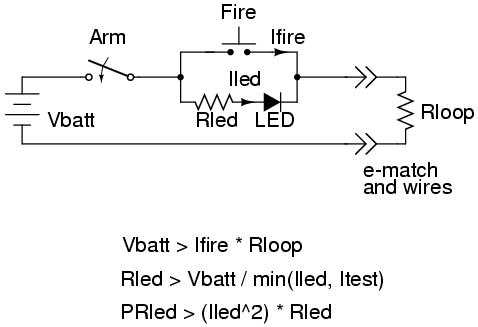

i had an idea for a board, would it work?
here's a simplified version, same components, just less e-matches.
6V source(in series with a resistor to cut current)(TEST)
6-12V source(no resistor)(GO)
(GO)--------\
(TEST) -------(SWITCH)(either, not both at same time)---LED---E-matchy---0V
would my LED blow before the e-match?
any questions, just ask
thanks.
#80 alany
alany
  • 740 posts
Posted 14 September 2005 - 11:29 AM
Very likely yes. Just use the "standard" topology:
http://www.vk2zay.ne...tachment.php/34

i knew there was a better way, thanks alot.
