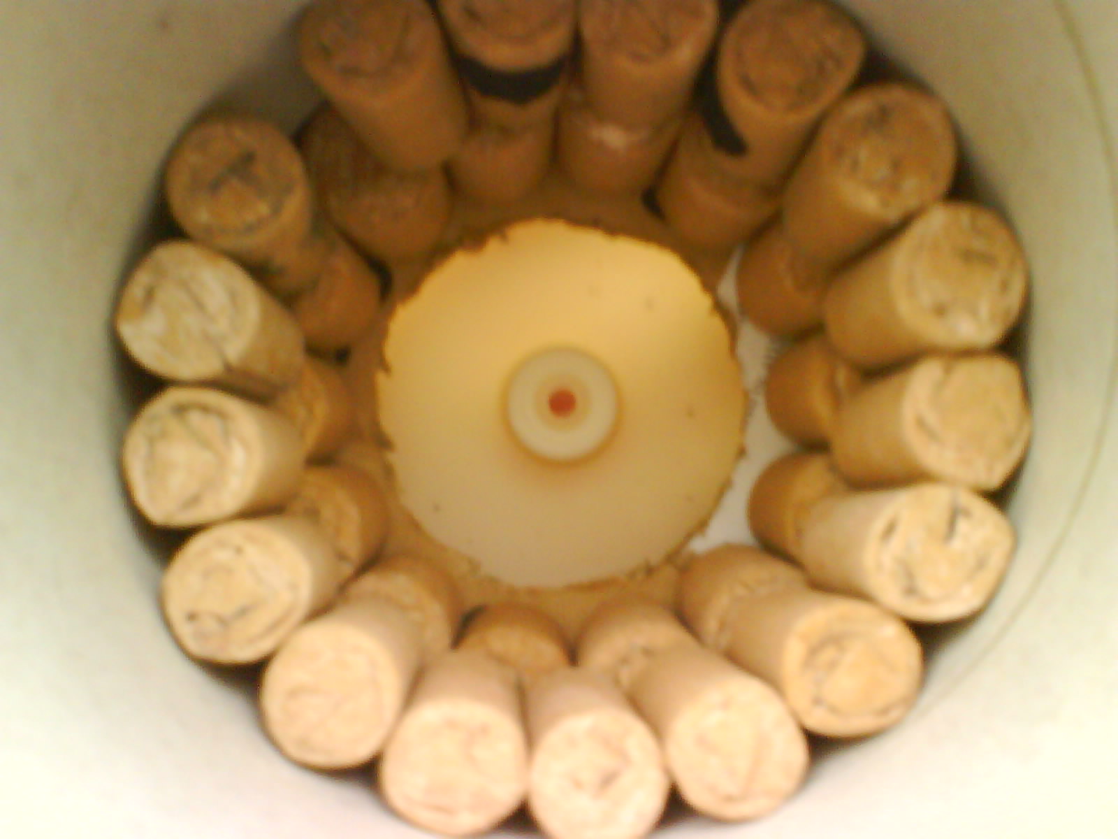

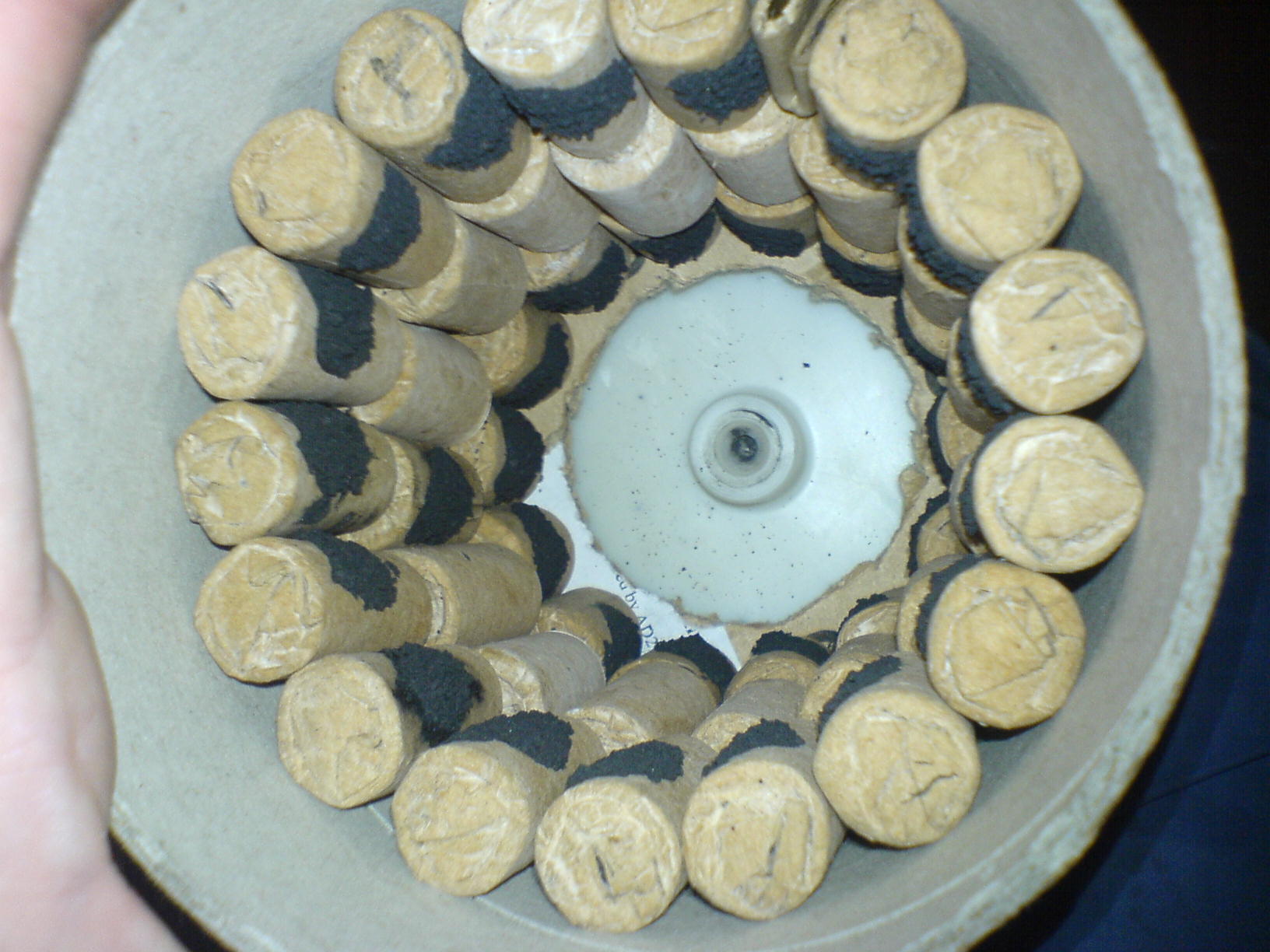

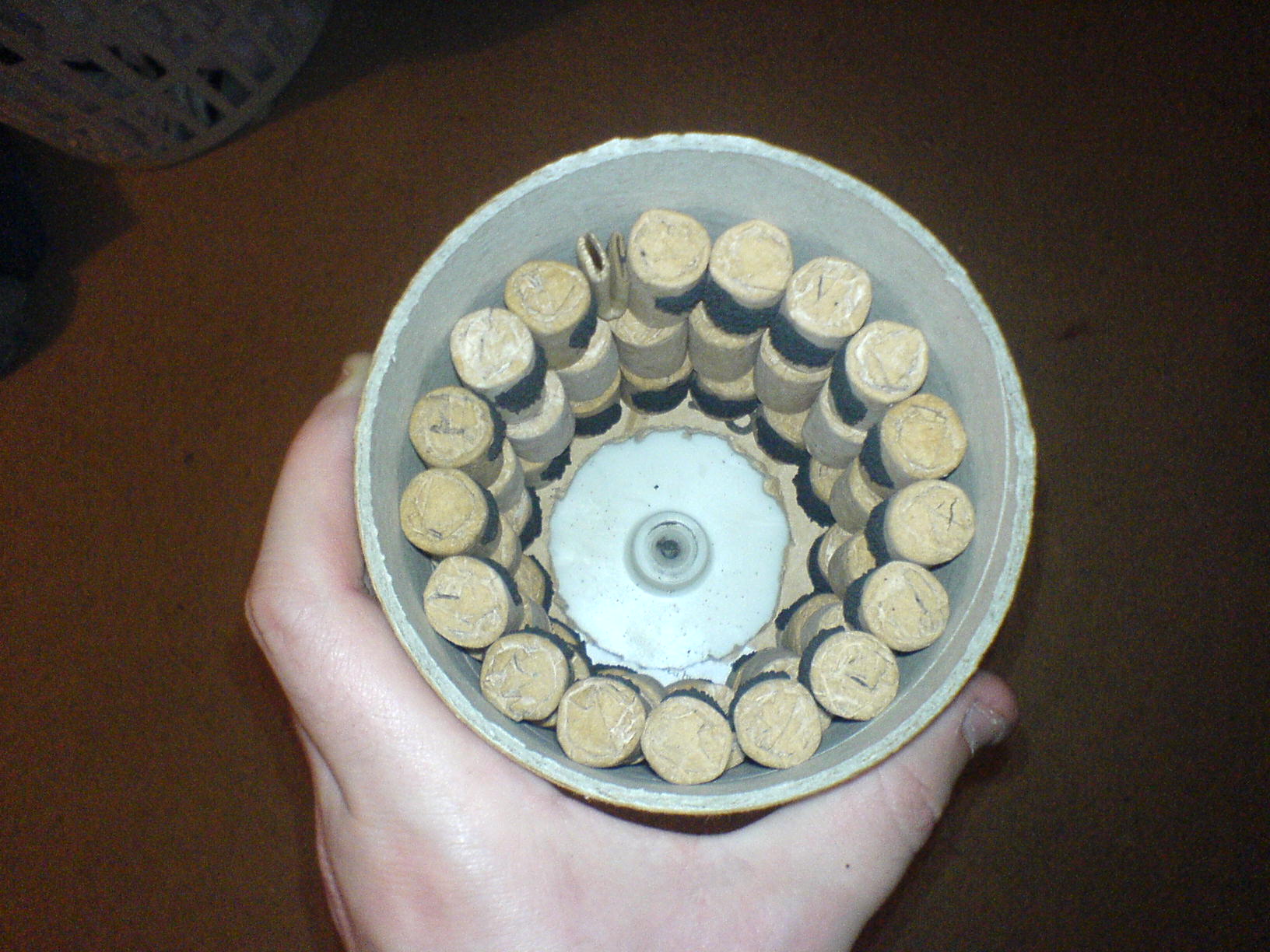

Here is a shot of the 5" Beraq shell, inside will be 18 for the first ring, 16 for the second and 14 for the last ring. The rings will get louder as the cases are slightly thicker on each one. They need the delay and prime (apart from 2 of the smallest beraq) then I will fill them and set them in the case. The card ring at the bottom is to give them a solid base to stand on.

The hummers were 50/50 BP meal and whistle with 8% Ti. I'll have to measure the casings but they were something like 3/8" ID and 1" OD X 1.25" long. They had really thick walls. I can't seem to get any duration out of them. Maybe straight BP with a smaller vent would work. Your pics Karl are exactly how I loaded the hummers, I just cut the visco to three different lengths and primed it for the timing. I faced all the fuses inboard though so they would be in direct contact with the break charge.
