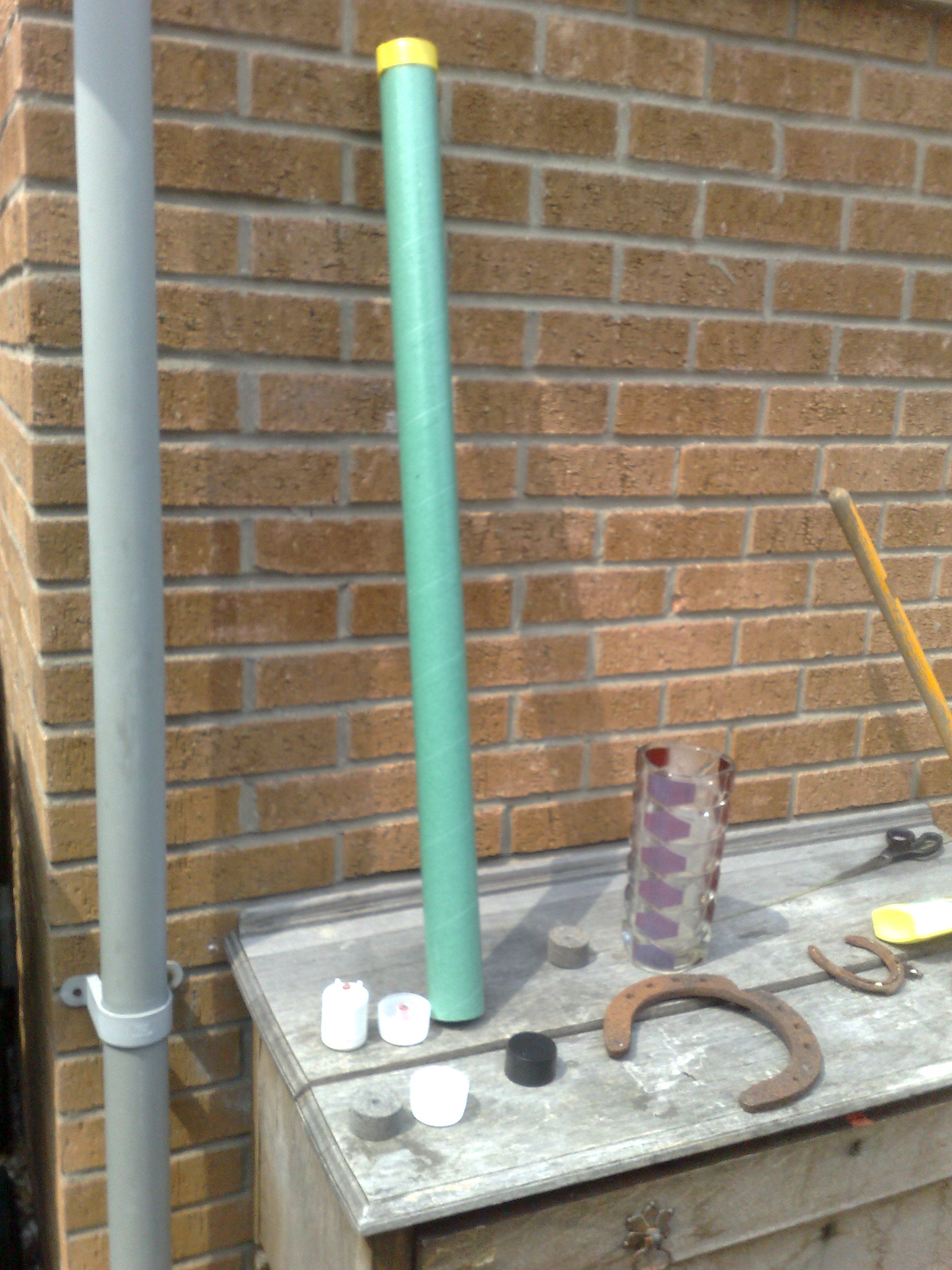

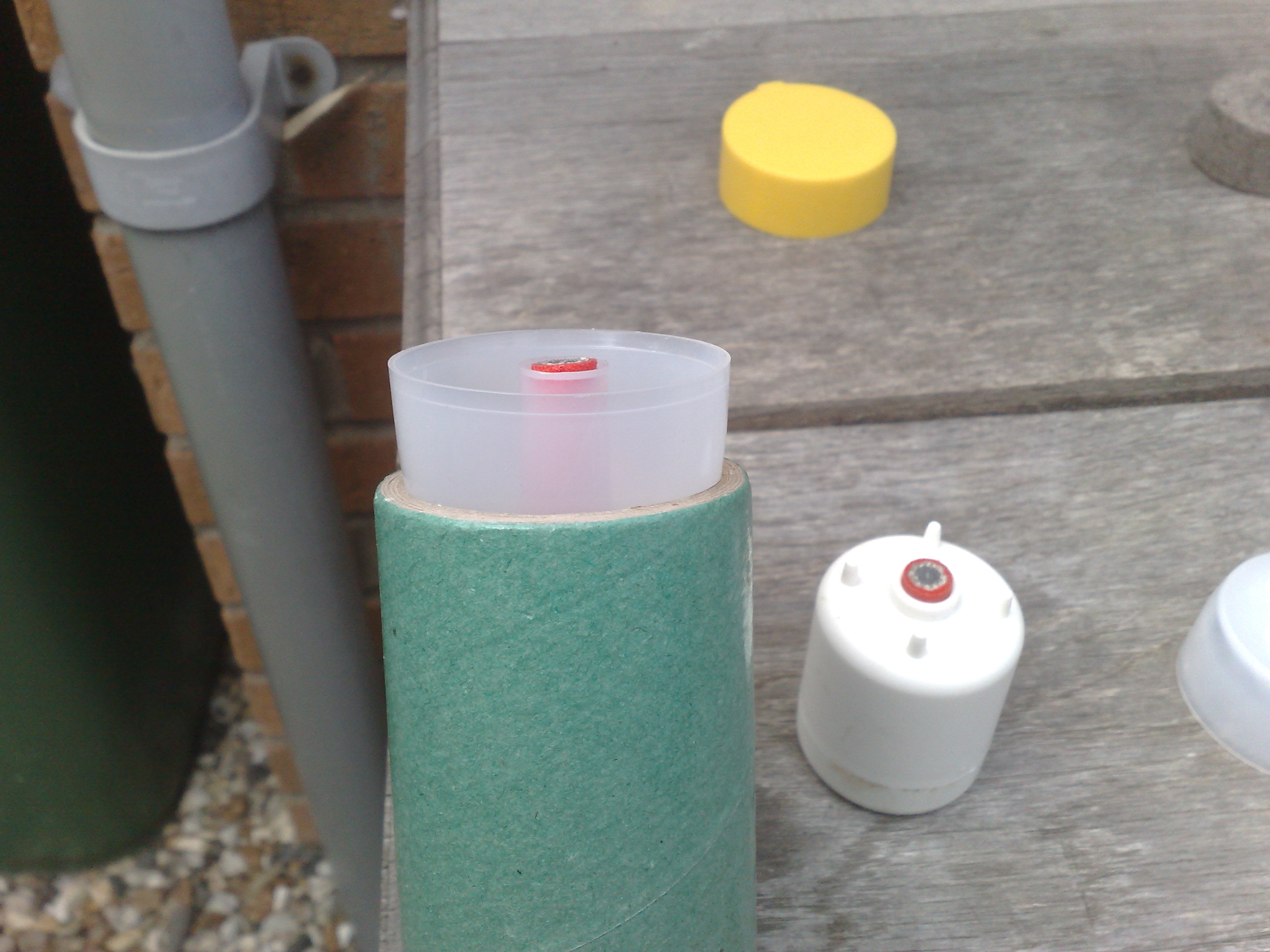

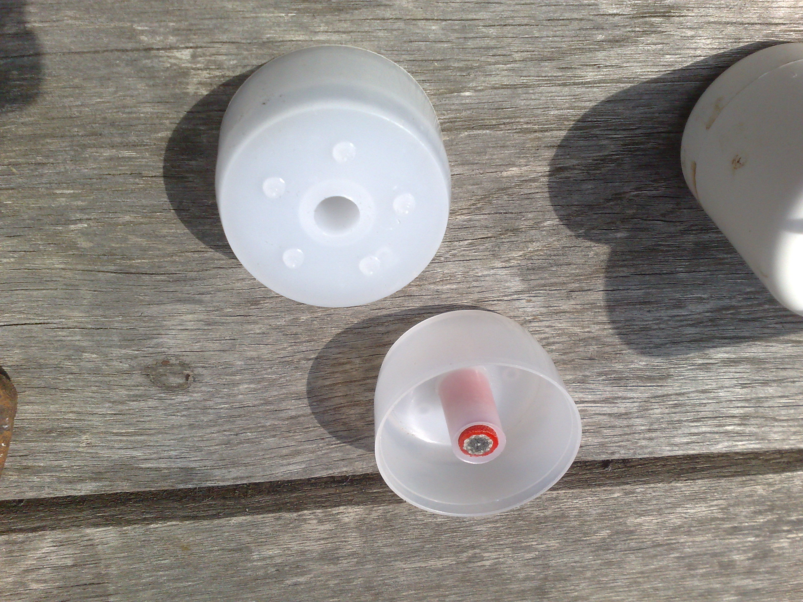

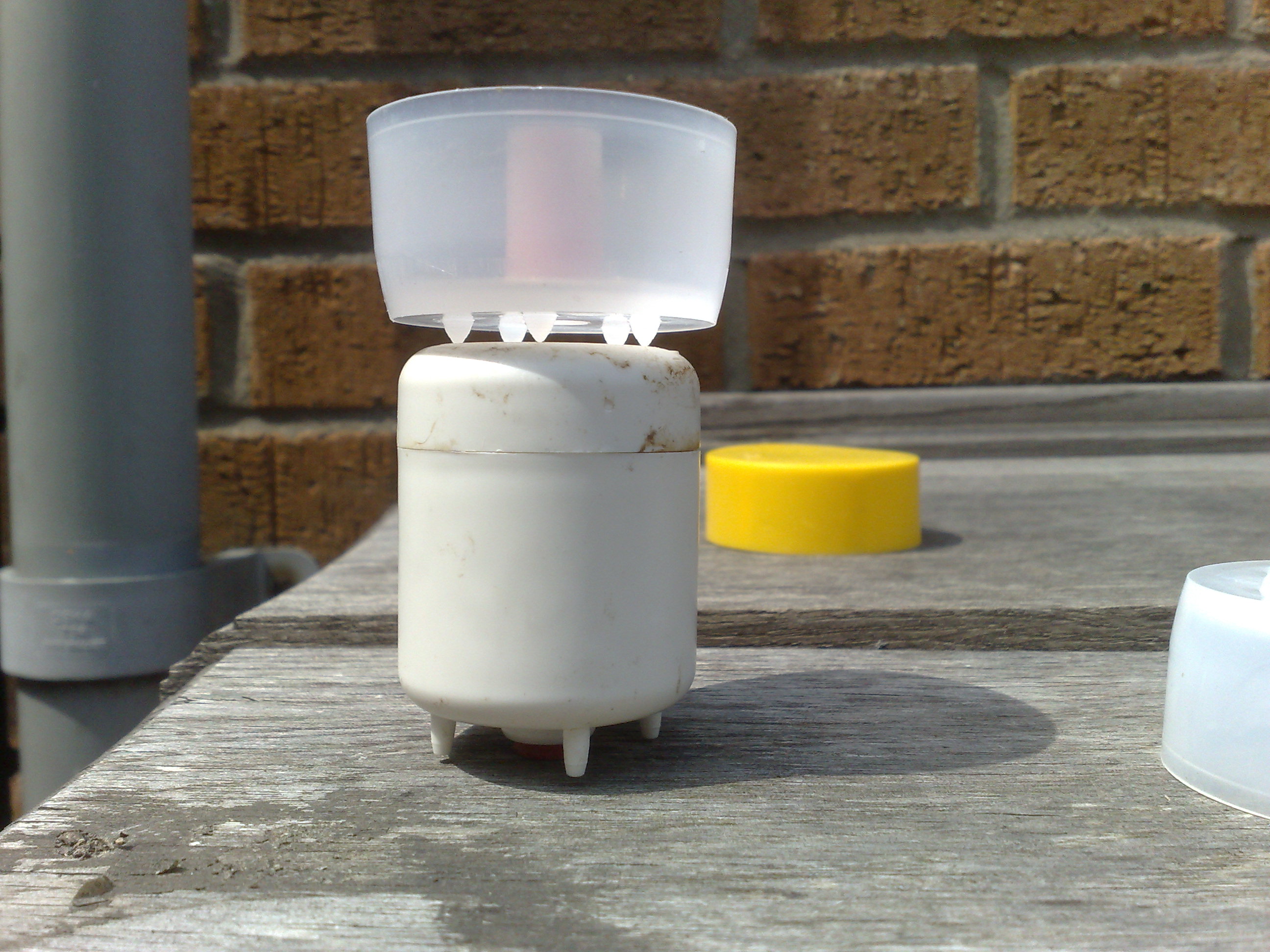

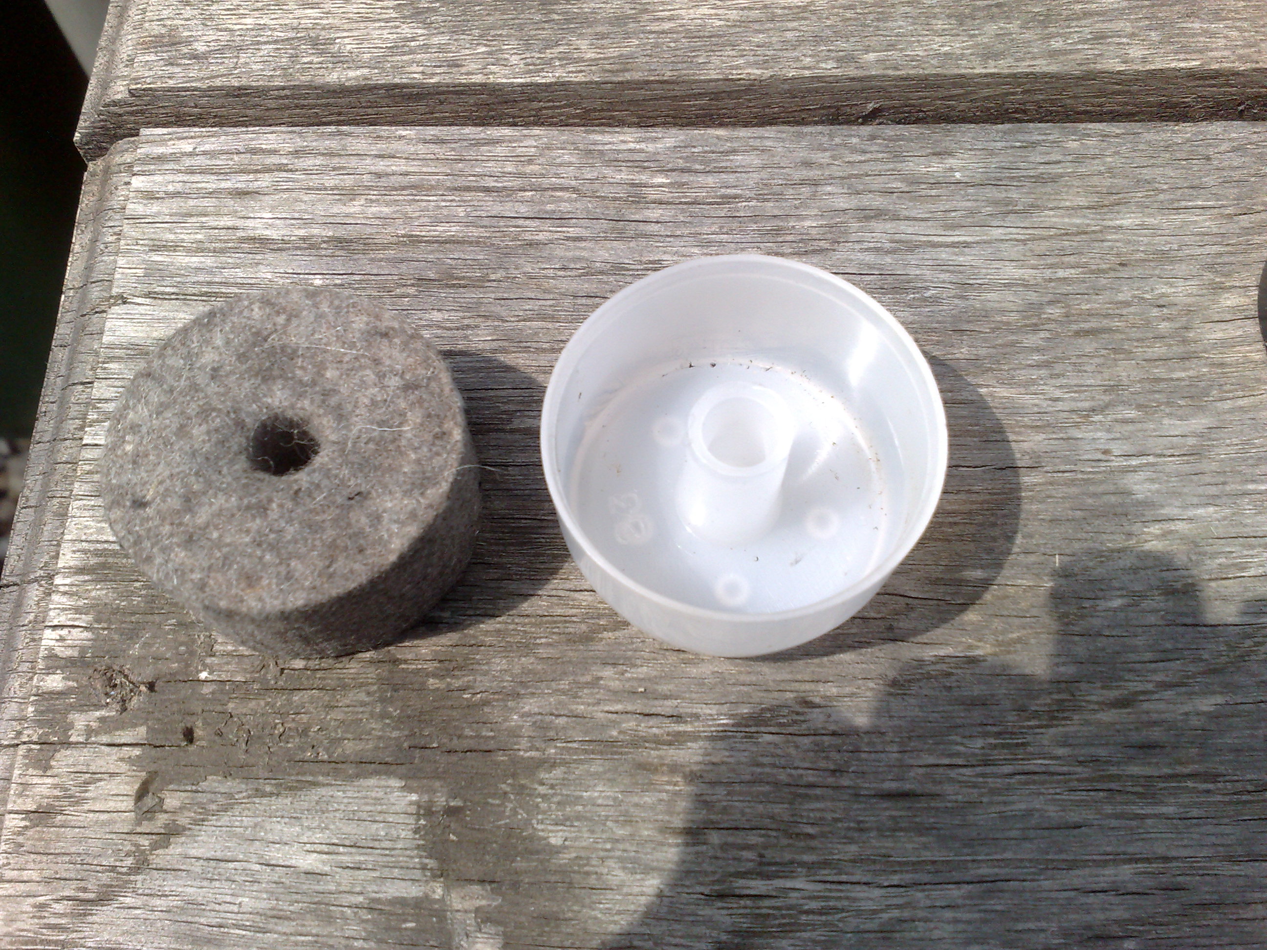

The Gamon wads require no wadding :) They are designed for use as they come.
#33 karlfoxman
  • 1,138 posts
Posted 24 May 2008 - 07:40 PM
Cheers Rich! I have some pictures anyway, I seem to remember some at their factory and they had no felt. Here are the pics.....
