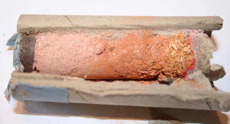

Here is a 'leak' from the next Spark!
Internal diameter, 1 inch.
The tube is grotty and spiral wound, thickness just under 1/4 inch.
Wow Phil, I take it that the real mcCoy then? Now I'm confused, that makes the tube thicker than the usual 1/8" walled tubes I use. I thought it was supposed to be thinner to burn away with the comp?

#11 phildunford
Posted 22 June 2010 - 08:23 PM
Maxman
Yup - that's the real item. Seems that they were short enough that the light could be seen at the mouth without the tube burning away.
Wish I could remember if that was definitely the case, let loads off when I was a kid, but can't remember if the case stayed intact, I think it did, but it's 40 years since I've seen one!

Posted 23 June 2010 - 06:08 AM
I've got some details of the Traffic Lights....
The 1970's/80's style Traffic Lights I have has a 31 mm outside diameter tube. Inside diameter is 26 mm. Tube thickness is 2.5 mm which seems very thin for a fountain. The tube height is 88 mm. I'm pretty sure they came in several sizes.
The mid 1990's style is smaller at 25 mm outside diameter tube. Inside diameter is 19.0 mm. Tube thickness is increased to 3.0 mm. The tube height is 82 mm.
