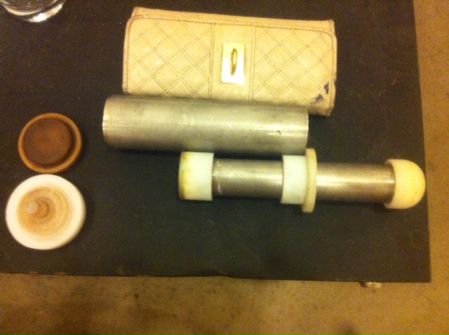

#5 cooperman435
Posted 18 September 2012 - 11:43 PM
That's what it looks like
This is a 2" comet pump, actual ID is about 42 or 45 mm to allow a leader or wrapping of shatter/crosette comets.
The two bases on the left are top flat comet and bottom shatter comet, I've never actually made up a crosette end for it yet.

#10 martyn
martyn
  • 470 posts
Posted 20 September 2012 - 10:21 PM
What's a shatter comet? :blush:
Perhaps I know it by another name - is it a comet which uses a rolled shot rather than powder in the crosette cavity?
#11 cooperman435
Posted 20 September 2012 - 10:34 PM
shatter is similar to crosette but hasnt the inwards deflected square hole, simply a round one (see the picture I put up as theres a shatter comet plug in it)
they simply shatter randomely rather than split perfectly into 4 peices
