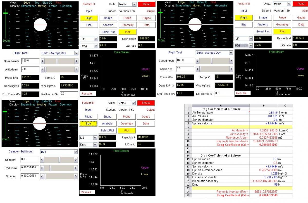

As I have already stated that: The XLS file I'm working on, will have 3 calculation tabs.
Internal Ballistics: calculates, newtons of force, acceleration, shell/mortar friction, & more.
External Ballistics: calculates, Reynolds number vs drag coefficient, Vertical Trajectory Calculations, & more.
Ballistics Data: all relevant ballistics data.
And I intend to include a, "Ballistic Chronograph" tab also.

Simply utilising commercial shell data, "Approximately 2.68 inches (68 mm) in diameter and the shells had an average total mass of approximately 4.8 ounces (130 grams)", to calculate W = mg = 0.13kg x 9.8 m/s2 = 1.274N
If you choose to "take it out of context", for whatever reason, WELL?
By the way the friction force is dependent on inclination, hence you can't say the frictional force of a horizontal tube equates to that of a vertical one.
And you thing I don't know that? I'm interested in measuring the total "frictional force" (W = mg = 0.13kg x 9.8 m/s2 = 1.274N) at horizontal as the maximum. As the mortar incline moves from horizontal to vertical the frictional force changes proportional to angle.
Actually, Ff = uN
Ff = frictional force
u = friction coefficients
N = Newtons (W = mg)
