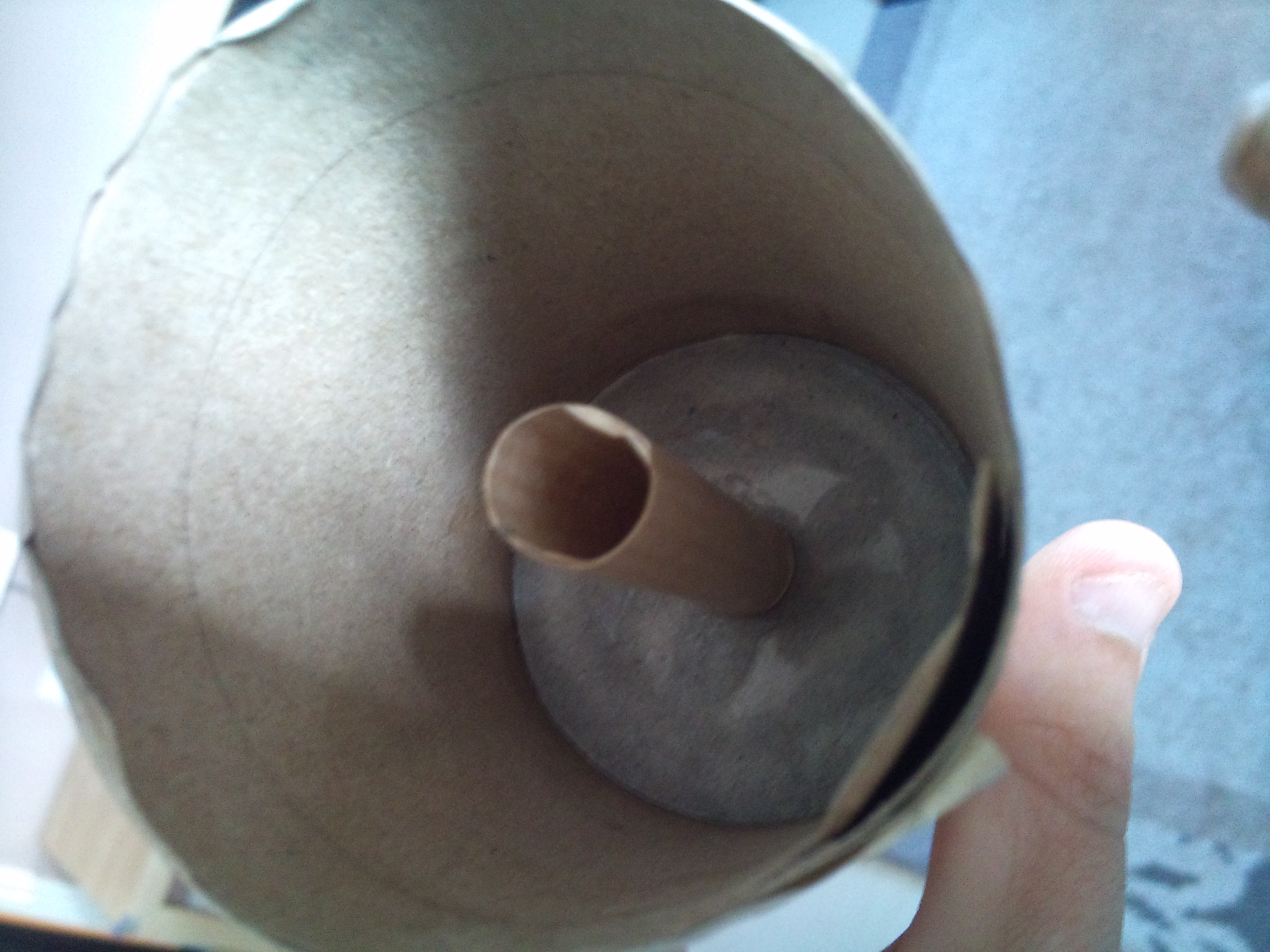

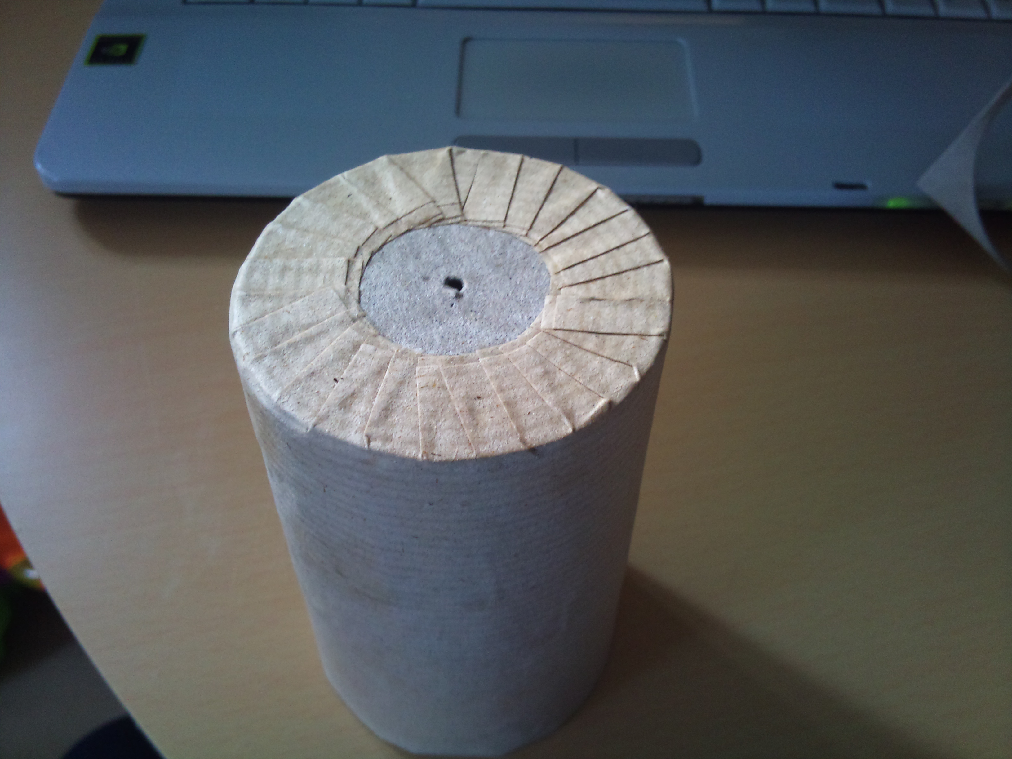

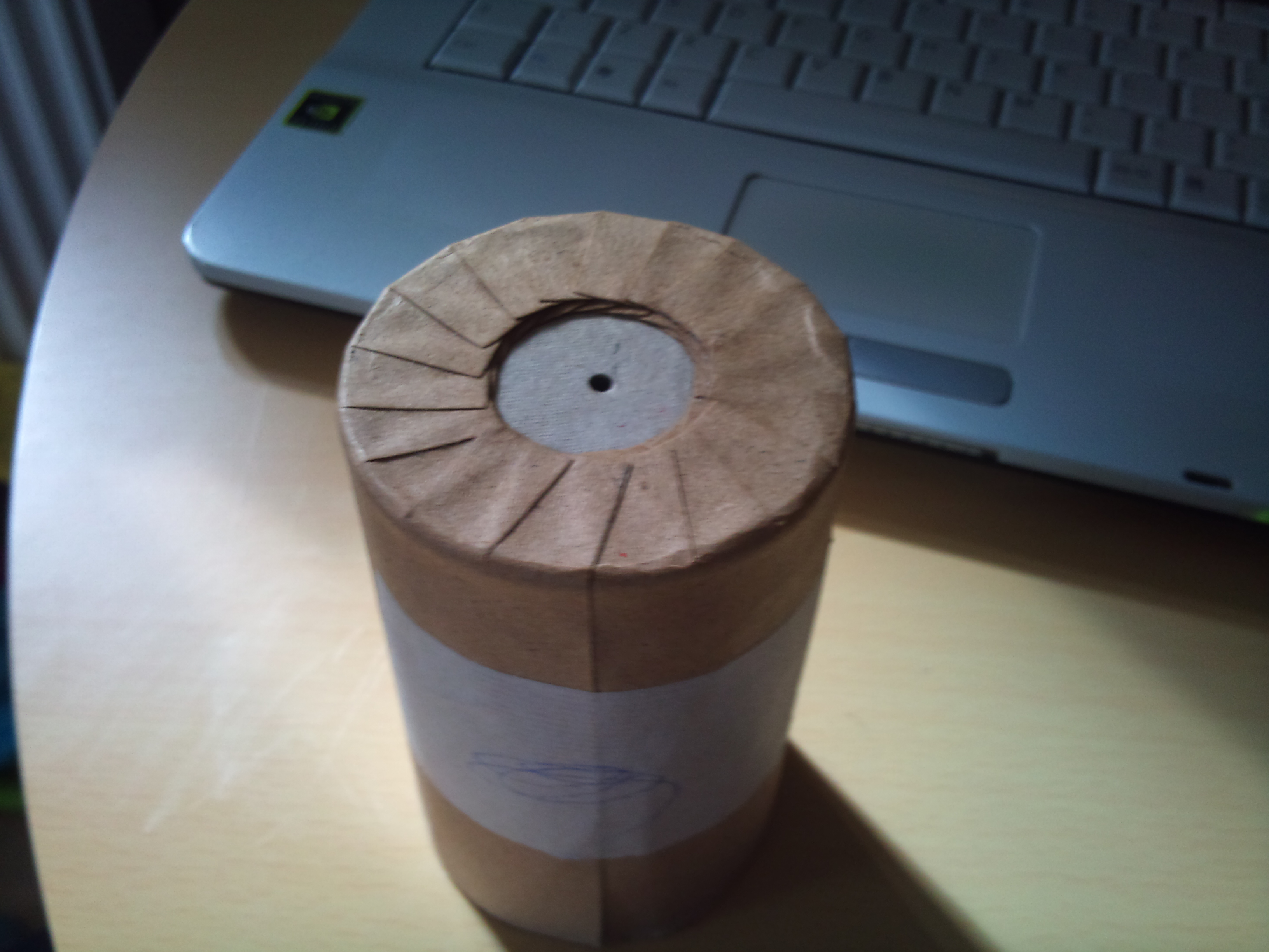

Following my post in the 'nice rockets' thread I have some pictures of the shell casing to hold the Beraq. The shell will be a simple single ring half and half Yellow/Aqua beraq. I could put two rings inside with no problem but this seems pointless for a first try. As you can see the pictures show how the paper is pleated down in stages using two end disks. The line inside is to show the limit of filling space before the end needs closing off.

I like the way you pleat over the end's, nice to see how it should be done.

Thanks. The way I do it is the same for large 6 & 7 inch but the disks are fiber
board. I will roll the beraq later :-)

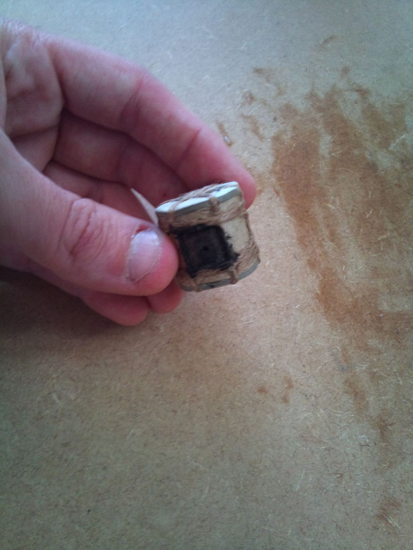

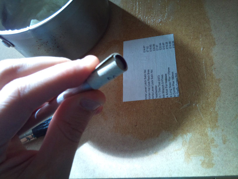

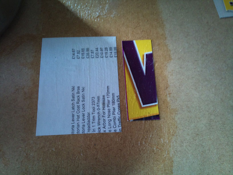

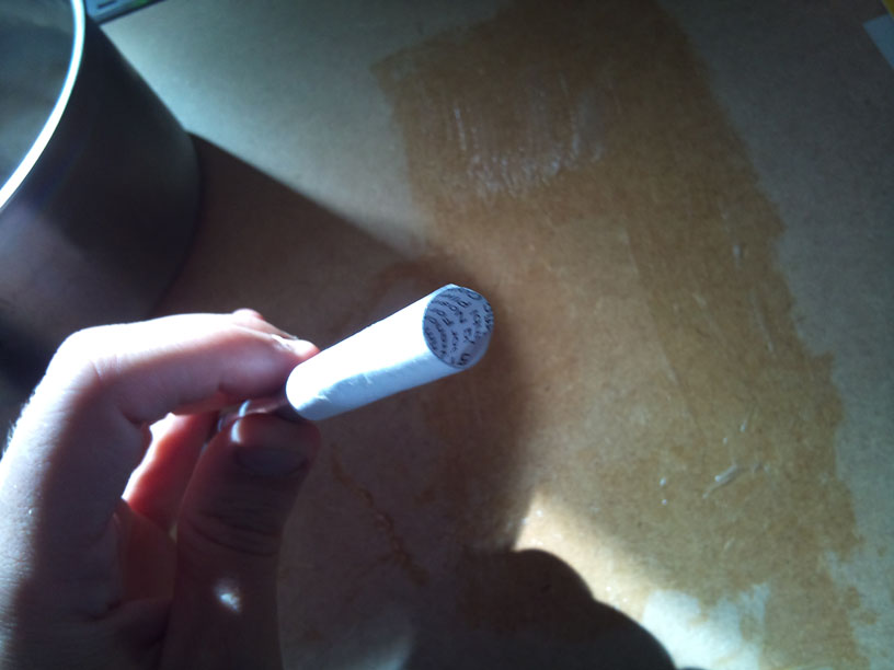

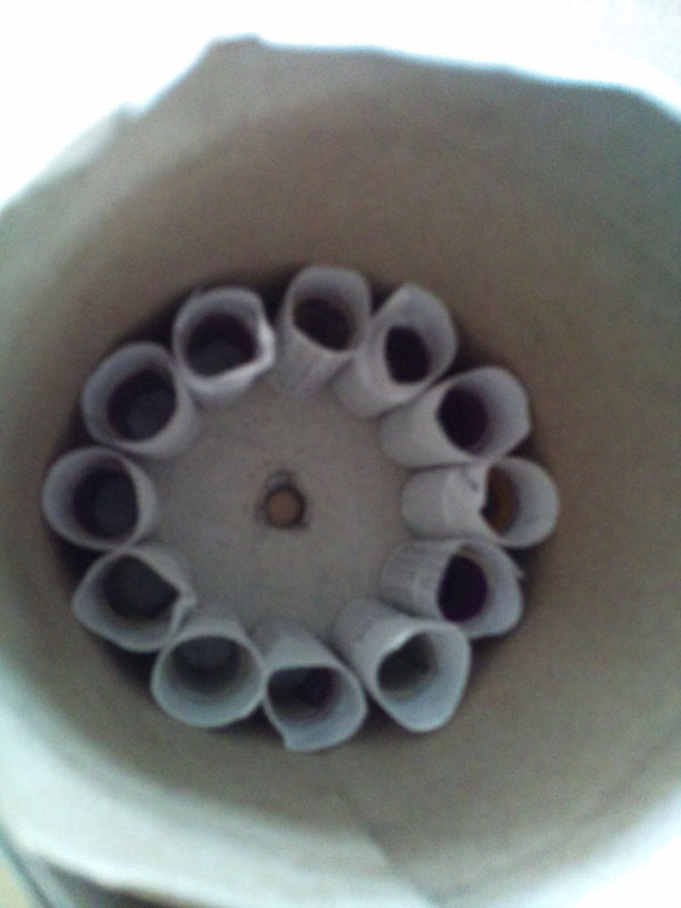

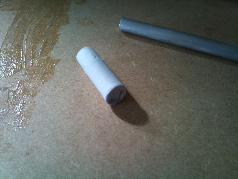

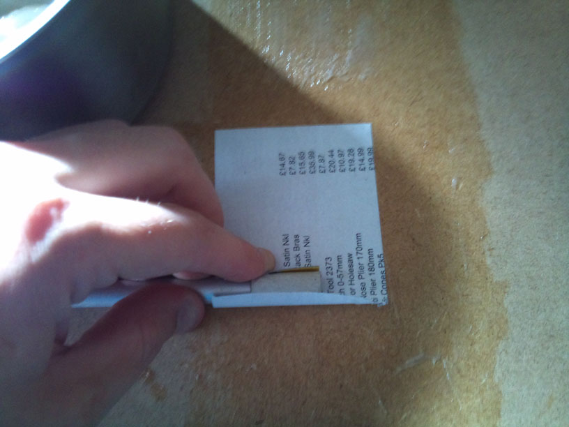

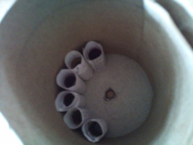

Here are some pictures
0084 : Strip of card enough for 2 turns around 3/8" former 1" wide also paper for 2 turns and overhang.
0085 : Pasted card rolled around former.
0086 : Rolling card in paper leaving enough both ends.
0087 : Rolled.
0088 : End sealed.
0090/0093 : Showing beraq inside shell.
Obviously these are not filled, when they are the end will be closed and then rolled in two more turns paper and sealed well at both ends. When fully dry the beraq are dipped in 50:50 pva/water and dried once more. Then the hole of 1.4mm brass pin is made, the delay is then inserted using a small knife. The timing depends on paste and how hard I push the delay in. Then the beraq are primed with fine grain BP.
If enough intrest I can bring some unfilled beraq and parts to Stanford Hall maybe give 'quick' demo on making them as I will be needed live side rigging.
Also added picture of a 3/4" ID second noise Beraq. It was used to practice filling delays.
