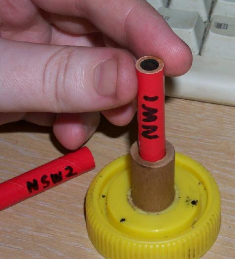

To do my burn-rate tests I charge 1/4" tubes 2" long about 1/2 full. I charge them flat against the desk, so at the powder is flush with the end of the tube. Then I measure the powder train length with a vernier caliper (one that can measure depth and subtract from the tube length).
The tube is then ignited with blackmatch and the burn recorded on video with a digital camera. The audio track gives quite reliable (nearest 10 ms or so) burn times, but a stop watch can be used on the video if the audio is too weak. I use an audio spectrogram program (Baudline) to extract the data, its waterfall view makes it easy to see and measure the time the composition was actually burning.
If you wish to replicate the conditions as exactly as possible, I use Pyrotube 1/4" ID x 2" tubes. I weigh the tube carefully before and after charging so I can get a good approximation of the density I rammed the composition to. This is more useful for repeatability than normalizing the results.
I place the charged tube empty-half up in a testing stand which I made from a 20 mm off-cut of 2 oz (Skylighter) rocket tube hot-melt glued to a plastic jar lid as a stand:
