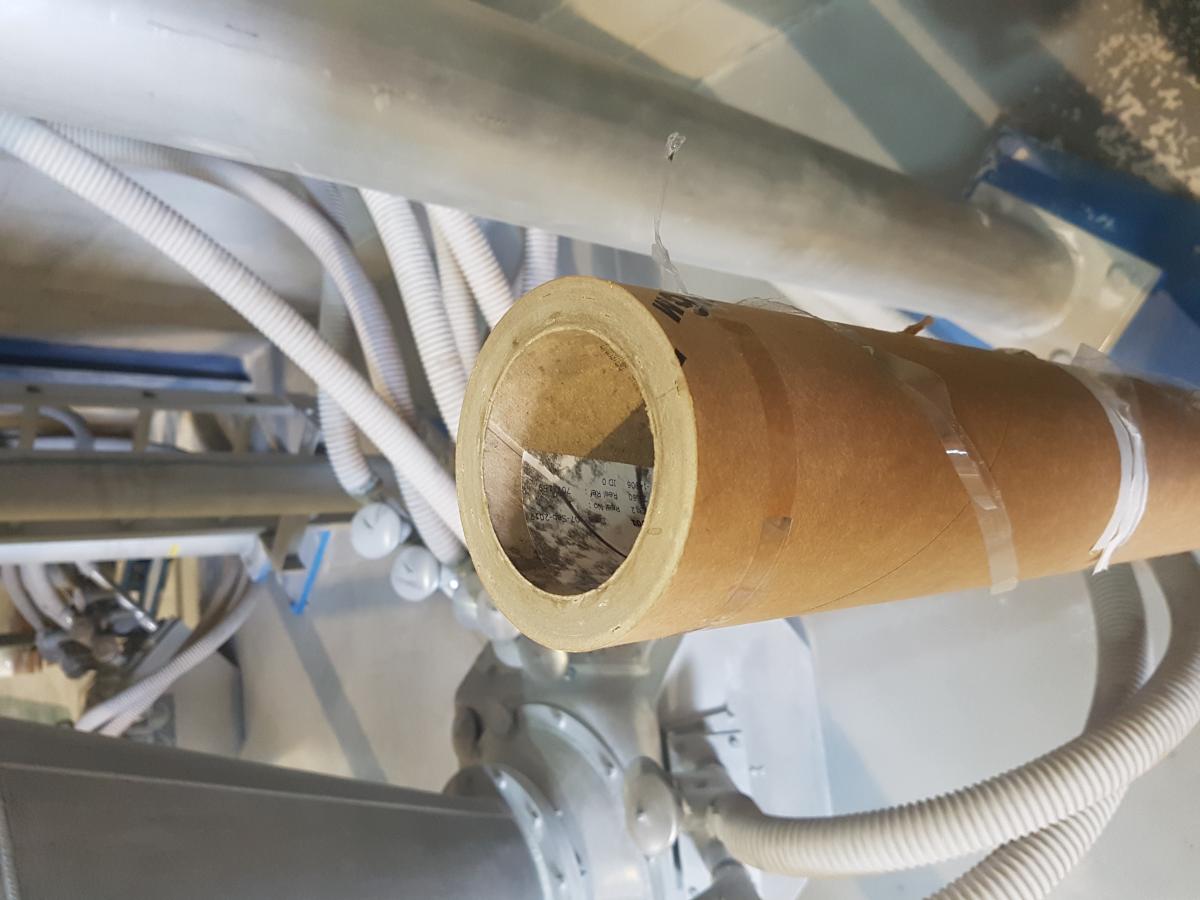

Hi would these be ok for 3" mortar tubes?
The I/D is 3 inch and wall thickness is 11mm. 450mm length.
Thankyou.
Neil.

I'd say that would survive the abuse well yep, maybe worth pouring 50/50 pva and water into the tube and allowing to soak in after bunging it to increase its water resistance internally and decrease it unwinding after firing from

I was thinking the exact same thing lol to stop it unwinding and edges from freying. Just temporary for now as I will at some point have some tubes from yourself, very good value. I can't believe how hard it is to find a bit of glass or hdpe tube unless I buy by the mile lol.
