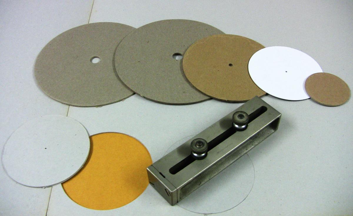

Posted by bangkokpyro on 27 April 2013 - 12:06 PM
You can't beat an Allpax gasket cutter for making end discs. It will cut through 1/8 thick cardboard with ease. You can adjust it to cut any size of disc and once you get into the hang of using you can cut hundreds of discs in an hour.
You can often find them second hand on ebay.
